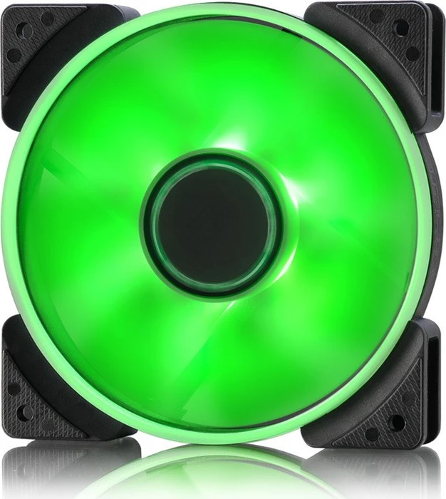

For currently more than 23 Euros, this ARGB fan is already an offer from the somewhat higher price segment, but still cheap, if you sort the top models in the right price range and the fan also does what it is said to do. The fan is exactly within the norm with its 25 mm thickness, which of course makes it more comparable in the end, especially since the rest of the design also tends to follow current trends and doesn’t reveal any daring design stunts at first glance either.
Included is only the fan including 4 screws, but that’s enough, because the RGB fans can also be cascaded. The bearing is based on a classic sleeve bearing, which is to be given better running properties with an additional magnet. We will see later if and how this works. However, the marketing term “LLS” bearing ultimately stands for nothing more than “Long Life Span”, i.e. a bearing with higher durability (MTBF). But it sounds good already, marketing goal achieved.
Let’s take a look inside the open fan. We recognize a classic 4-pole motor, the control board with a total of six LEDs, the cable leads hidden in the hollow (and somewhat thicker) motor strut as well as the simple sleeve bearing with vast amounts of appropriate bearing grease. Pressed and mounted everything is on the simple but quite torsion-resistant frame construction with a total of 4 struts.
The rotor (impeller) as a counterpart to the stator is a translucent block with a total of seven rotor blades, slightly rounded and beveled edges and corners, as well as the obligatory pressed-in ring magnet as a rotor and the axle made of stainless steel. The translucent fan blades and the outer ring fitted into the frame were specially designed for even illumination, which compensates quite well for the rather low number of LEDs and avoids visible light spots. The ARGB control supports the normal digital 5-Volt connectors of the motherboards and thus also Asus AURA, Gigabyte Fusion, MSI Mystic Light, ASRock Polychrome and other systems, which are also based on the same technology.
Everything is supported by a black, simple frame, which visually hides no secrets at first glance. The PWM-controlled fan manages a speed range from 500 to 2000 rpm and does not offer a semi-passive mode (i.e. no fan stop) when PWM-controlled (20% minimum).  The decoupling with the comprehensively attached rubber corners is well solved, because it does not twist with the tightened screw. The gap dimensions and surface finish are good. The power consumption turns out exemplary low with under 2 watts for the fan (without ARGB) at full speeds.
