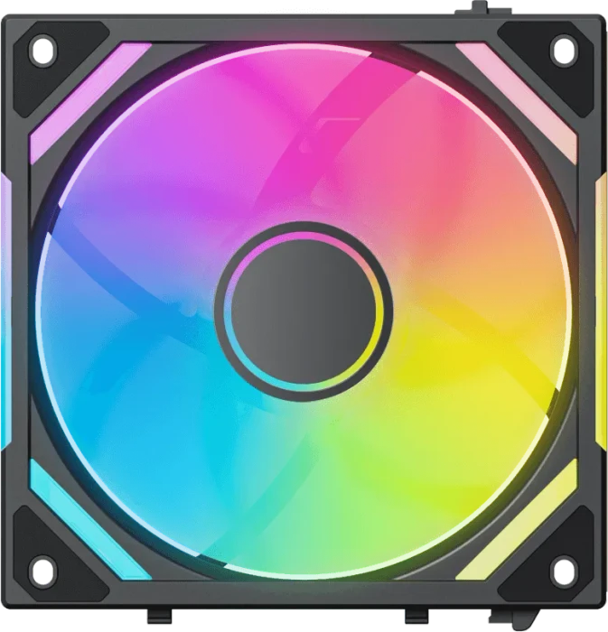

With the Alpenföhn Wing Boost 3 ARGB High Speed, EKL expands its own portfolio with a bright 120 mm case fan, which is available in black and white. You can either buy it separately or as a triple pack with RGB controller and remote control. But since we don’t want to evaluate the colorful appearance, but the performance, we naturally focus on the individual piece. After we had already tested the unlit Wing Boost 3 as a 140 mm variant some time ago and various questions remained unanswered, it will be interesting to see how the obviously also once again revised 120 mm model performs.
The fan tested today was sent to us by the manufacturer’s marketing department (unfortunately loose and without packaging) as part of the post-processing of the last test, so that the same is missing from the picture gallery of the fan. Here I ask for your indulgence and we can only hope that the sample sent to us is really normal retail goods. But after a closer look at the fan, we assume that this is probably the case, otherwise we wouldn’t have done the test either. Nevertheless, in the conclusion I will still have to address why fanciful data sheet claims should not be used to mislead customers.
The bearing is a classic FDB (Fluid-Dynamic Bearing) design, a white, slightly more torsion-resistant frame and an 11-blade rotor with an asymmetrical blade geometry that doesn’t hide any secrets at first glance. Compared to older models, the impeller seems a bit more massive, which in combination with the different frame could have eliminated the annoying humming of the older models. ARGB is of course also available with this fan, whereby the LEDs are not located in the hub, but in the static frame. The PWM-controlled fan manages a speed range from 500 to 2200 rpm and does without a semi-passive mode (with fan stop), but relies on a permanent minimum speed.
The decoupling with the comprehensively attached rubber applications is neatly solved, as it does not twist with the screw tightened. The gap dimensions and surface finish are good. The power consumption turns out to be quite steep with more than 4 watts at full speed. It a light disc on the market more, which is now to be tested intensively. But first of all once again the key data for better comparability to the later measurement results:
