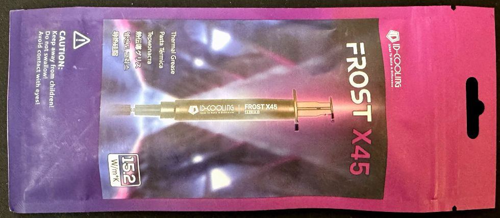

ID Cooling
Bezeichnung
SYY 157
Frost X45

15.2

Spatula
Container
Bag
Plastic Box

Above-average performing paste, higher filled with bigger particles to reach the high conductivity, suitable for GPU and CPU, but viscous (needs to warm up before application).
