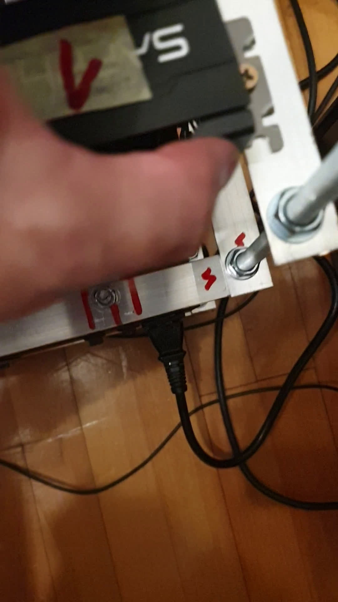

New STRANGE findings on my Sapphire Pulses.
1) After installing the same, working rig into a bigger aluminium construction for cooling, both rigs now all of a sudden show a card with Samsung memory. Before it was all Micron memory. Now two cards with Samsung.
2) I have one AMD Sapphire blower card, 5700(non XT). That one has decent memory temp. 78C at 65% fan. Everything else, as before, 88 C with autofan on and pretty big fan values.
Here's the thing though-when manipulating the cards I felt the backplate being slightly loose on all cards. Like if you jiggle it against the card, the backplate and cooling assembly has a little bit of play. Some screws look like they are not all the way in but once you try them with a screwdriver they are tight. Here is the video of me jiggling it a little.
Can anyone else with a Pulse, or any other card, try the same and report their findings? This is very curious.
Cards are all new, I just put the rig into work and am testing for a week maybe.
3) On the 2 PSU, 13 card rig. It had a power consumption of 980 W and 890 W, around 1870w total. Now it is 1020 W and 850 W . Software power usage is the same for all, roughly speaking.
Greetings
